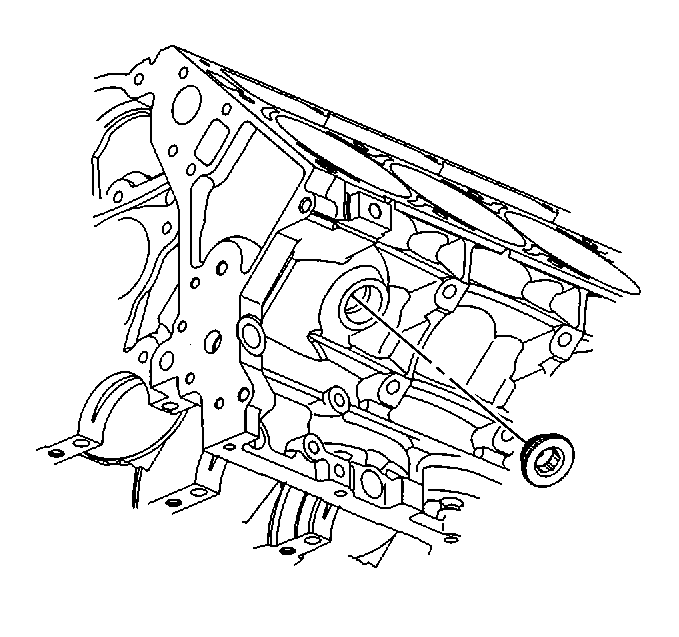

- Remove the right side engine block
drain hole plug.
Engine Drain, Right Side
- Remove the left side engine block drain
hole plug.
Engine Drain, Left Side
- Allow the cooling system to drain
completely.

- Install the left side engine block
drain hole plug.
- Install the right side engine block
drain hole plug.
- Close the radiator drain cock. Tighten
- Tighten the drain hole plugs to
60 N�m (44 lb ft).
